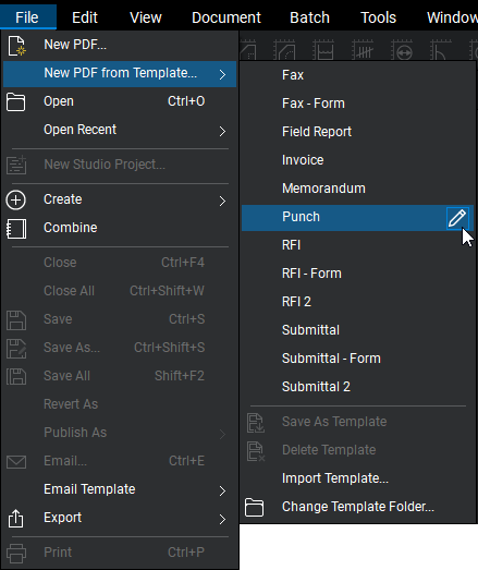

Templates exist as special files in Revu and should be edited in Revu.
To edit an existing template:
Go to File > New from Template and click the
Edit button that appears to the right of the desired template when you hover your mouse over that area.
- Only templates from the active Template folder are listed. If the desired template is not shown, select Change Template Folder, then navigate to and select the folder it's in.
- When the Template opens, it will have an icon on its tab that lets you know that it's a Template and not another document.

To delete a template in Revu:
- With the Template as the active file in Revu, go to File > New from Template > Delete Template. A confirmation dialog box will appear asking you to confirm that you wish to delete the template. Clicking Yes will delete the template.
