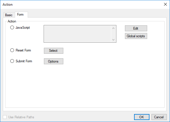

Form Actions are related to the fields in the PDF document. It is here that JavaScript calls may be invoked based on a specified trigger.
- JavaScript: JavaScript may be invoked as an action for a trigger. Use this field specify the trigger.
- Reset Form: Resets part or all of the form fields.

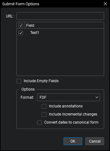

- Submit Form: A form may be submitted in PDF, FDF, or HTML form to a URL waiting for submittals. Click Options to configure submission options.
