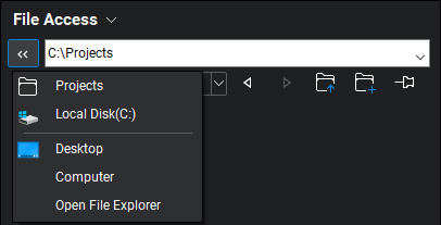

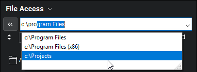

File Access Panel - Explorer Mode
The Explorer mode on the File Access panel provides access to the files on your computer and network within Revu, without using Windows Explorer or Open.
Double-click any PDF shown to open it in Revu in the foreground. Double-click a PDF while holding down CTRL to open it in the background.
On the File Access panel toolbar, go to File Access >  Explorer to access Explorer mode.
