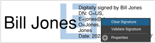

To clear your digital signature, either permanently or in order to make any needed changes and reapply it, right-click the signature and select Clear Signature.
You can only clear your own digital signature.
