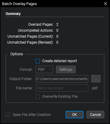

- Review the Summary information provided, which includes the pages that were overlaid and the name of the overlay document that was created for each page pair.
- To generate a report of the Summary information, follow these steps:
- Select Create detailed report.
- Choose PDF or CSV under Format.
- To change the folder in which the report will be saved, select the
button to the right of Output Folder and select the desired folder. - Enter a name for the report in the File name field.
- To overwrite an existing file with the same name in the selected folder, select Overwrite Existing File.
- To open the file once it's been created, select Open File After Creation.
