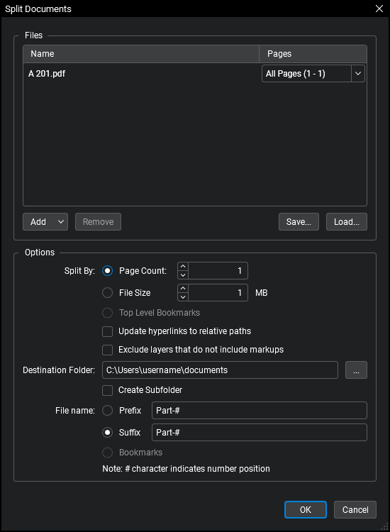

- Open the PDF to be split.
Go to Document > Split Document. The Split Documents dialog appears.
- To use a previously saved batch of PDFs, click Load and select the desired file.
The active PDF, if any, is automatically added to the process. To add more PDFs, click Add and use one or more of the following methods:
- Files: Adds individual files from a network or local drive. Selecting this option causes the Open dialog to appear. Navigate to the appropriate location and select the desired files.
- Open Files: Adds all files currently open in Revu.
- Open Set: Adds all files contained in the current Set.
- Folder: Adds all files in a selected folder on a network or local drive, but not files contained in any of its subfolders. Selecting this option causes the Select Folder dialog to appear. Navigate to the desired folder and select it.
- Folder and Subfolders: Adds all files in a selected folder on a network or local drive as well as all files within any of its subfolders. Selecting this option causes the Select Folder dialog to appear. Navigate to the desired folder and select it.
- By default, any document in the Files list will be split. To remove a document from the Files list, select it, and select Remove.
To split specific pages of a PDF, select it, then select the Pages menu and choose from the following:
- All Pages: Sets the range to all pages.
- Current: Sets the range to the current page only.
- Custom: Sets the range to a custom value. When you select this option, replace any text left in the field with the page or pages to be printed directly. To enter a custom range:
- Use a dash between page numbers to define those two pages and all pages in between.
- Use a comma to define pages that are separated.
For example: 1-3, 5, 9 will include pages 1, 2, 3, 5 and 9.
- To save this batch of PDFs for later use, select Save and save the file to a local or network drive.
- Select the method that should be used to split the PDF from these Split By options:
- Page Count: Splits the document by a user-defined number of pages (entered in the Page Count field). The pages in the source PDF will be uniformly split by that number. If the PDF does not divide evenly into that number, the final document will contain the remainder. For example, a ten-page document that is split using a Page Count of three will produce four new files: File 1 will contain pages 1-3; File 2 will contain pages 4-6; File 3 will contain pages 7-9; File 4 will contain page 10.
- File Size: Splits the document by a user-defined file size (in MB, entered in the File Size MB field). If the PDF does not divide evenly into that number, the final document will contain the remainder. For example, a 10MB PDF that is split using a File Size MB of three will produce four new files: Files 1-3 will be roughly 3MB; File 4 will be roughly 1MB.
- Top Level Bookmarks: Splits the document progressively forward based on its bookmarks.
- Select Update hyperlinks with relative paths to automatically update hyperlinks within the resulting split files that were created using relative paths.
- Select Exclude layers that do not include markups to automatically exclude any layers that would normally be included in the split document if those layers do not contain any markups.
- Enter the location of the folder where the resulting PDFs should be saved in the Folder field. Select the
button to browse to the folder location.- Select Create Subfolder to create a new subfolder and save the resulting PDFs in it.
- Select a naming style from the File Name menu. The options available vary slightly depending on the Split By selection made earlier:
Prefix or Suffix: Adds the file number plus any text entered in the associated field to the end (suffix) or beginning (prefix) of the source PDF's file name to create file names for the split files.
For example, when splitting document ABC.pdf into four parts, selecting Suffix creates four files named ABC1.pdf, ABC2.pdf, ABC3.pdf, and ABC4.pdf.
When defining a suffix or prefix, use the number sign (#) to control the position of the file number. If the location of the file number is not specified, it will be added to the end of the suffix or prefix automatically.
- Bookmarks: Available only when the Split By method selected is Top Level Bookmarks, this option splits files by taking the name of the top-level bookmarks without reference to the source file's name.
- Select OK. The Split Document dialog closes and the split files are created.
