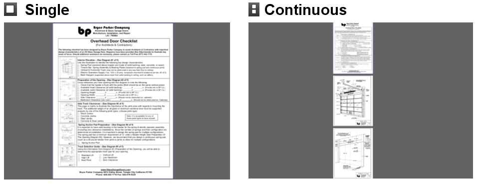

To set the page layout, select the desired mode from the View menu:
Single Page Mode: Fits individual pages to the current workspace window.
Continuous Mode: Shows all pages in a single column.
Side-by-Side: Shows two pages side-by-side per window with the even page on the right and the odd page on the left. If Show Cover Page in Side-by-Side is enabled, the first page will be shown alone and the rest will exhibit this behavior.
Continuous Side-by-Side: Shows all pages in the side-by-side mode in one continuous window. If Show Cover Page in Side-by-Side is enabled, the first page will be shown alone and the rest will exhibit this behavior.
