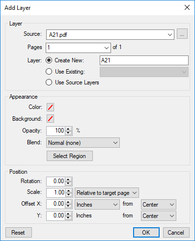

In the Add Layer dialog:
- The PDFs currently open in Revu are listed in the Source dropdown menu. Select one to use it. Otherwise, select
to the right of the Source menu and navigate to the desired PDF. -
Select a page range from the Pages dropdown menu to determine which pages of the source file will be added.
- All Pages: Sets the range to all pages.
- Current: Sets the range to the current page only. The current page number will appear in parentheses, for example, Current (2) if page 2 is the current page.
- Selected: Sets the range to the current selection. This option only appears if pages were selected prior to invoking the command.
- Custom: Sets the range to a custom value. When you select this option, replace any text left in the field with the page or pages to be printed directly. To enter a custom range:
- Use a dash between page numbers to define those two pages and all pages in between.
- Use a comma to define pages that are separated.
For example: 1-3, 5, 9 will include pages 1, 2, 3, 5 and 9.
- Select one of the Layer options:
- To create a new layer from the source PDF, select Create New and enter a name for the layer in the field to the right.
- To add the source PDF to an existing layer, select Use Existing and select the desired layer.
- To import the layers of the source PDF as duplicate layers, select Use Source Layers.
- Select the Color to choose a color to which this layer is to be converted.
- The Background can be changed to a range of colors but is set to transparent as a default. If you choose to change this to a solid color to block out any underlying layers, make sure to change the Blend mode to Normal.
- Define the Opacity to set the transparency of the content in the layer. 100% (fully opaque) is the default.
- Select a Blend mode to determine how the color of overlapping elements will be treated. For example, the "Darken" option will cause elements that overlap on different layers to be combined into a third, darker color.
- To choose a specific region of the source page, select Select Region and define the desired region by selecting the points of the shape or by dragging a rectangle.
- The Position options allow you to fine tune the layers if they are not perfectly scaled or if they are slightly skewed (please note that while you can manually adjust Layers with these settings, it is generally recommended that you use the Align Points function described below when possible):
- Rotation allows you to rotate the layer between 0 and 360 degrees.
- Scale allows you to make the layer larger or smaller, where 1.00 is equal to 100% (so, for example, a 75% scale should be entered as .75 while a 125% scale should be entered as 1.25).
- Offset X & Y allows you to move the layer left/right or up/down.
- Select OK.
