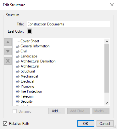

Editing a Structure creates or modifies the structure tree. The structure tree should mirror the way you want bookmarks using the Structure to be created. For example, if you create a branch of your structure tree called "General Information" and it has an object "G-000" under it, creating a bookmark from it will automatically create the bookmark as General Information/G-000.
Creating the structure tree is like creating the bookmarks in a PDF but without defining the link to the page. The structure tree should contain all of the bookmarks that you might want create in documents that will use the Structure, even if that bookmark is not frequently used.
The Edit Structure dialog appears when you are creating a new Structure or modifying an existing one (see Working with Bookmark Structures above). It is where the structure tree is defined.
In this dialog , you can edit the following:
Title: The name of the Structure as it appears within Revu. Enter the desired name in this field.
Leaf Color: The color that will be applied to bookmark names created using the Structure. Select the color box to select a different color.
Dynamic: Determines whether the names of bookmarks created using the currently selected object are static or dynamic. Select this option for dynamic bookmark names. Each individual object in the structure tree is defined as static or dynamic (the default is static).
Static bookmarks will be created with the exact name that appears in the Structure.
Dynamic bookmarks can be renamed when they are created. You will have the option to manually rename the bookmark or, if it includes a numeric value, have it automatically proceed to the next, unused name in the sequence. For example, when enabled, the first bookmark created using an object called G-000 will take that name. Subsequent bookmarks created using it will be automatically named "G-001", "G-002", and so on.
Add: Creates a new object in the structure tree at the same level as the one that is currently selected. If none are currently selected, the new object will be at the top-most level.
Add Child: Creates a new object in the structure tree as a child of the one that is currently selected.
Modify: Allows you to change the name of an object in the structure tree. Select the desired object and click this button to make the name editable.
Relative Path: Determines whether bookmarks created using the Structure use a Relative Path or a Full Path. See Working with Bookmarks: Relative and Full Paths for a discussion about Relative versus Full Path.
Use the
up,
down, and
delete buttons to reorder or delete structure tree objects.
