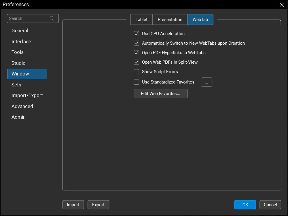

When Revu is configured to use Standard Favorites, you will have two lists of Web Favorites: the Standard Favorites and your local Favorites. You can use a Standard Favorites XML file that is saved on a local or a network drive, though only one Standard Favorites list can be used at a time. Standard Favorites are loaded every time Revu is opened; changes made to a Standard Favorites XML file will not show up until you close and reopen Revu.
Go to Revu >
Preferences. -
Go to Window > WebTab.
- Select Use Standardized Favorites, and select
. - Browse to the location of the desired Standard Favorites file, then select it and select Open.
- Select OK.
