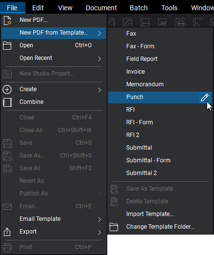

Templates exist as special files in Revu and should be edited in Revu.
Go to File > New from Template and select
Edit to the right of the desired template when you hover over that area.
- Only templates from the active Template folder are listed. If the desired template is not shown, select Change Template Folder, then navigate to and select the folder it's in.
