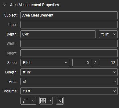

The Measurement Properties section shows properties pertaining to the selected measurement. All measurements have Subject and Label properties, and when no measurement tool is selected, that's all that you will see.
Entering text in these fields (with no measurement tool selected) will create default values for the Subject or Label properties that will persist across all tools. If these fields are unavailable, select the Use legacy persist behavior for Subject and Label preference in Measure Preferences.
Other properties appear, as appropriate, when the various tools are selected.
Subject: Defines the subject for the selected measurement markup. Subject is reported in the Markups list; giving similar markups similar subjects can make them easier to work with in Markups list.
Label: Defines the label for the selected measurement markup. The label is reported in the Markups list and appears on the markup itself by default.
Show Caption: Determines what measurement captions are shown on the drawing. Select the desired captions or disable Show Caption to turn off all captions.
Depth: Defines the depth for the selected measurement, which is used to calculate volume and wall area. Can be set before placing the measurement (but after an applicable measurement type is selected) or after selecting an existing markup.
Width: Shows the width (to scale) of the measurement. For the document width, see the Layout section of the Properties tab.
Height: Shows the height (to scale) of the measurement. For the document height, see the Layout section of the Properties tab.
Slope: Describes the slope ratio for the measurement, allowing for accurate calculations of materials over a sloped plane. To set a slope, select a unit of measure for it (Pitch, Degree, or Grade) and enter the value in the corresponding field.
Length: Sets the unit of measure for the length dimension of the measurement.
Area: Sets the unit of measure for the area dimension of the measurement.
Volume: Sets the unit of measure for the volume dimension of the measurement.
