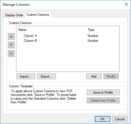

On the Markups list toolbar, go to Markups List > Columns > Manage Columns. The Manage Columns dialog appears.
Select the Custom Columns tab. Existing Custom Columns (if any) are listed.
Select Add. The Add Column dialog appears.
In the Name field, enter a name for the column (in this example, enter "Column C").
From the Type list, select Formula. The fields available under Options automatically update.

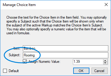

To add a choice item, select Add. The Manage Choice Item dialog opens.
Enter the name of the material in the Item field. This will be the name that users will see when choosing a material, so make it something meaningful and recognizable.
- To take advantage of Revu's ability to automatically filter choices for you in the Markups list, enter a Subject that matches the Subject of the markup the material applies to. For example, let's say that you're going to create flooring materials. When you define a floor area with the Area markup, give it a Subject (for example, "Flooring") in the Properties panel:
Now, if you also set up your material to have the same subject...
...then when you go to choose something from the Material menu for your Flooring markup, you're only going to see Flooring materials.
Choice items that have no Subject will show up for any markup, so technically you would see materials that have a Subject equal to "Flooring" or that have no Subject at all.Using this feature, you can create as long a list of materials as you need for your project. Users will always be able to select building materials in the same place (the "Material" column), but the list of choices will be manageable and appropriate to the markup.
Select Assign Numeric Value and enter the base cost of the material in the field next to it.
