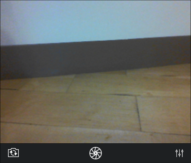

Image from Camera. The camera preview window appears.
- If more than one camera is attached to the device, select
Switch to toggle between them - To change the camera preferences before capturing the image, select
Preferences. - Select
Shutter to capture the media. - To use the resulting image, select Use. Otherwise, select Retake to attempt to capture the image again.

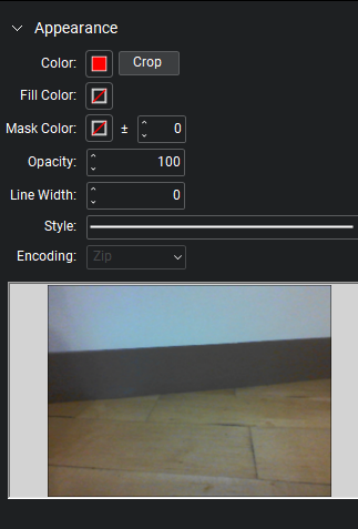

The appearance of the Image markup is configurable, including its outline style, line width and color,mask color, and opacity.
To change the appearance of an Image markup, select the markup and select the Properties panel. Go to Window > Panels > Properties to show the Properties panel if it is hidden. Several properties will also be available on the Properties toolbar when the markup is selected.
Color: Sets the color of the outline.
Crop: Select to Crop the image.
Fill Color: Sets the color of the interior fill of the image. Note that the Opacity needs to be reduced in order to see the effects of this setting.

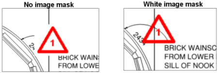

Mask Color: Set this value to make a certain color of the image completely transparent. Any pixel in the image that is the defined Mask Color will pass through any underlying colors on the PDF through the image so that the portion of the image will appear transparent. For example, setting this value to white when you have an image on a white background and are placing on a black-and-white PDF will let the underlying PDF content show through the background, as in the example below. Set the Mask Tolerance by pressing the up/down controls to fine tune the sensitivity in which the underlying content shows through the mask color for the image. Increasing this setting tends to give a smoother appearance so that the image appears more natural in the PDF.
Opacity: Sets the level of transparency of the Image. Reducing this from the value of 100 will let the underlying PDF be seen through the image. If a Fill Color is set, the image will take on the color as defined in the Fill Color Setting.
Line Width: Sets the thickness of the line surrounding the image in points.
Style: Determines the type of line used to surround the image annotation.
When Style is set to Cloud, the Size and Invert settings are also available.
Size: Sets the width of the cloud segments.
Invert: Inverts the cloud segments inward on the shape.
Size = 2.00
Size = 1.00 and Inverted
Encoding: Determines the method for saving the Image once it has been embedded in the PDF. The available choices are ZIP or JPEG. In general, ZIP is better for graphics, and JPEG is better for photos.
An image preview window shows a thumbnail version of the image. Double-click on the thumbnail to swap the image for another image.
