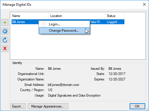

You can change the password for a self-signed, PKCS #12 digital ID file from the Manage Digital IDs dialog box. Because digital IDs stored in the Windows Certificate Store are linked to your Windows login credentials, their passwords change when those credentials change. They cannot be changed in Revu.
To change the password for a self-signed digital ID, follow these steps:
- Go to Tools > Signatures > Digital IDs. The Manage Digital IDs dialog appears.
Right-click the desired PKCS #12 digital ID and select Change Password.
In the Change Password dialog, enter the requested information.
Select OK.
Changing the password of a digital ID automatically logs you in with that ID. If that is not desired, right-click the ID and select Logout to log out of the ID.
