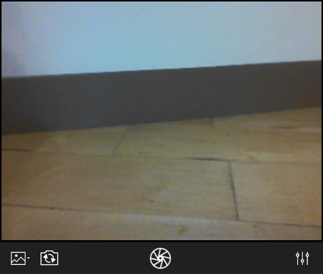

Sometimes an image or video can explain a problem much more effectively than a written note. Images and video can be embedded in a markup or images can be used to create new markups.
- Select the markup in which the image or video is to be embedded.
- Go to Tools > Markup > Image >
From Camera. Or , press CTRL+ALT+I or right-click the markup in which the image is to be embedded and go to Capture >
From Camera. The camera preview window appears.
- Select Photo (for an embedded image) or Video (for an embedded video) from the
Media Type menu in the lower-left corner of the camera preview window. - If more than one camera is attached to the device, select
Switch to toggle between them. - To change the Camera Preferences before capturing the image or video, select
Preferences. - Select
Shutter (for Photo) or
Lens (for Video) to capture the media. - To embed the captured media, select Use. The media is automatically embedded in the selected markup.
- To discard the media and capture it again, select Retake.
- Media embedded directly from the Camera tool automatically take the name of the markup's Subject, followed by a number as needed (for example, "Cracked Tile," then "Cracked Tile - 2," then "Cracked Tile - 3" and so on).
- To review images embedded in a markup, select the embedded media icon just below the markup (
) or in the Capture column (
) of the Markups list.
