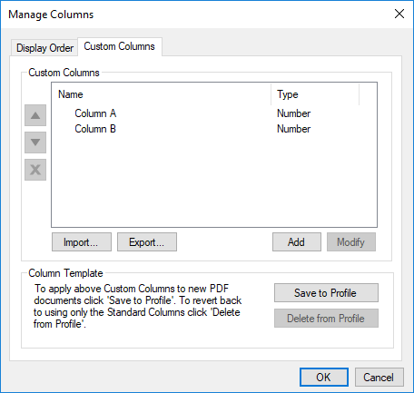

On the Markups list toolbar, go to Markups List > Columns > Manage Columns. The Manage Columns dialog appears.
Select the Custom Columns tab. Existing Custom Columns (if any) are listed.
Select Add. The Add Column dialog appears.
In the Name field, enter a name for the column (in this example, enter "Column C").
From the Type list, select Formula. The fields available under Options automatically update.

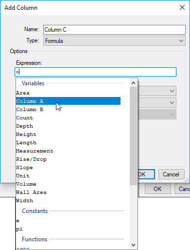

Select the Expression field and start typing the first part of your equation (in this example, start typing "Column A"). As soon as you start typing, a dropdown menu appears with available selections.
Double-click the first Variable of your equation (in this example, use "Column A"). It will automatically be added to the Expression field, properly formatted.
Enter a valid operator (in this example, enter "+") after the Variable.
