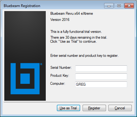

- When the Bluebeam Registration appears, enter the serial and product key listed on the License Certificate that was sent when the software was purchased, and click Register. Alternatively, click Use as Trial if you haven't purchased a license yet, or would like to complete the registration later. Clicking Cancel skips the registration process and also activates the trial.
