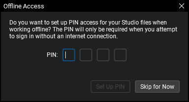

Studio files can be accessed even when a user is offline. Setting up an offline access PIN is an important part of protecting those documents. Once established, any user attempting to open a Studio file while offline from your device will need to enter the PIN first.
To set up an Offline Access PIN, follow these steps:
- Go to Revu >
Preferences. - Select Studio.
- On the Servers tab, select Offline Access.
- In the Offline Access dialog, enter the desired PIN. PINs must be four digits.
- Select Set Up PIN.
