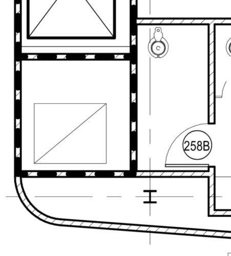

PDFs made with vector graphics use line weights to define the different types and styles of lines in your drawing. Disabling line weights allows you to see the vector lines that make up your PDF with no style applied to them, which can be helpful depending on your goal. This article discusses some of the ways that enabling and disabling line weights can help your workflows.
A document with line weights enabled.
A document with line weights disabled.
