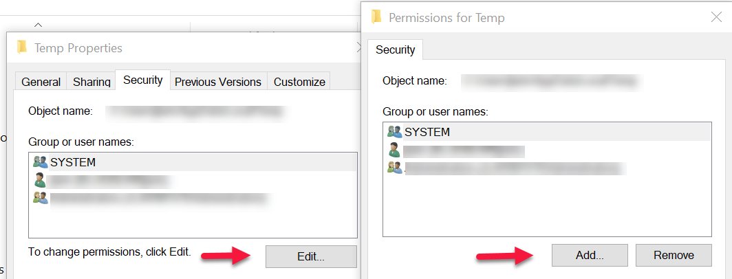

Edit Temp Folder Security Permissions
  1. Navigate to the following location in the File Explorer Window:
    C:\Users\YOUR USER NAME\AppData\Local\
  2. Locate the Temp folder. Right-click the folder and select Properties.
  3. Select the Security tab.
  4. Select Edit and then select Add.
  5. Type Everyone into the Object field. Select Check Names and then select OK.
  6. Select Everyone from the Group or user names list and then select Allow under Full Control.
  7. Select OK.
Once complete, restart your system and attempt reinstall Revu.
