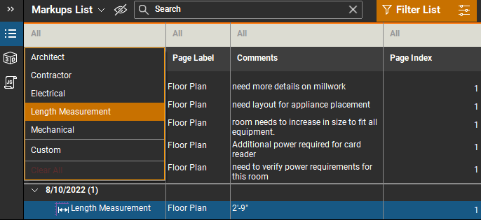

Update all measurement markups in a drawing
You can also update all measurement units (of the same type) in a drawing via the Markups List:
  1. Open the Markups List in the bottom left corner of the window.
  2. Select Filter List from the top of the panel.
  3. In the filter list, select the gray cell above the Subject column, and select the measurement type (ex: Length Measurement).
    Markups in a filtered list
  4. Select multiple markups by holding down Shift and clicking the measurements you'd like to update, or select all by clicking one list item and pressing Ctrl+A.
  5. From the Properties Toolbar or the Properties panel, select the desired units, and the selected measurement markups will update accordingly.
