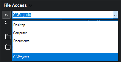

Path List: The Path List provides a quick way to navigate to local and network folders. To navigate to a known location, simply enter the path in the Path List field. As you do, the name will autocomplete and a list of folder names that match what you have entered will be shown. Use the UP ARROW and DOWN ARROW keys to select from the autocomplete list. Press ENTER to navigate to the folder that is currently selected.
Select the down-arrow
in the Path List to reveal Path List favorites. Desktop, Computer, and Documents are automatically saved as favorites at the top of the list. Folders that you have Pinned will appear below them.
