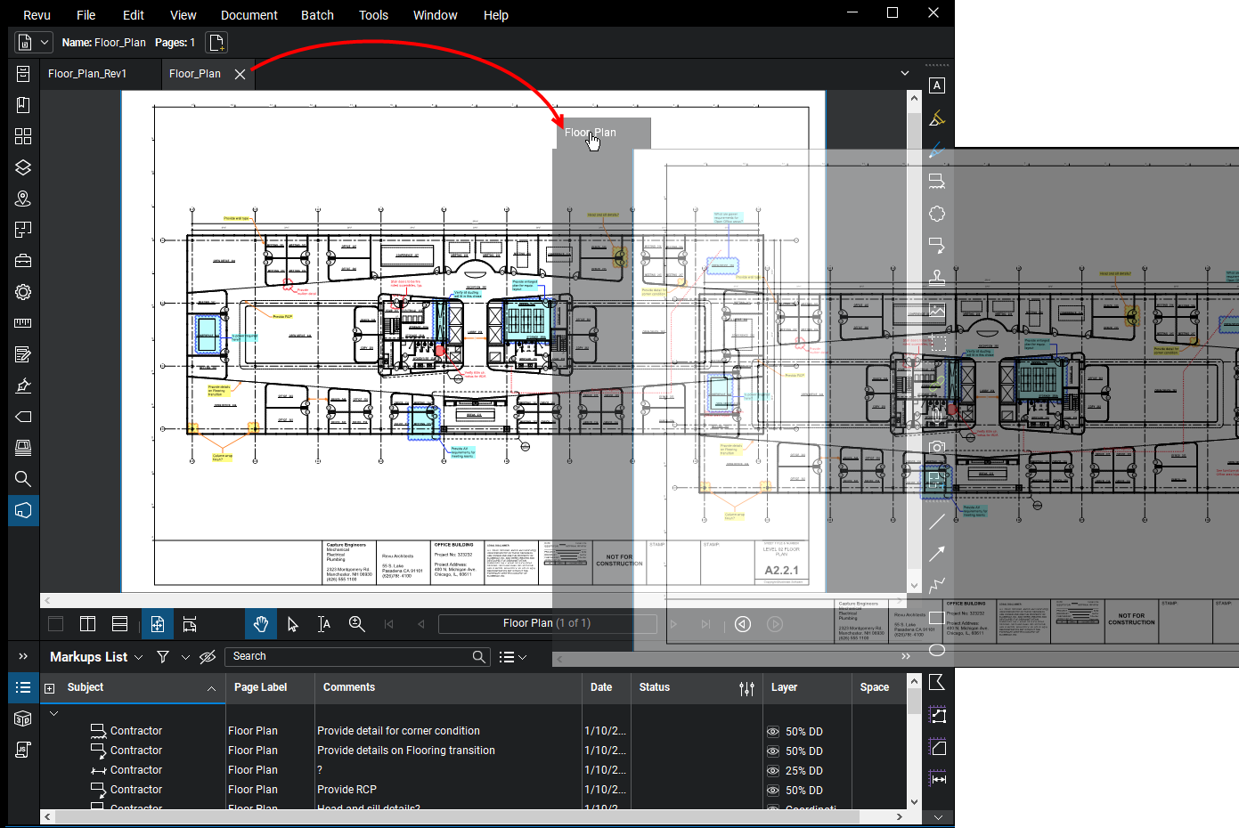

Note that you can also undock a PDF using a similar process, only instead of dragging the document tab to another split, drag it away from the document tab bar.
MultiView Extended lets you separate a document tab from the main workspace into a stand-alone, detached workspace. This is especially useful for working with multiple monitors.
- To detach a tab, drag the tab away from the document tab bar or right-click on a tab and select Detach.
- To detach a document tab while leaving that document open in the main workspace, hold down CTRL while dragging the document tab off the main window.
- To return the detached tab to the main workspace, click and drag the tab back to the document tab bar.

The example below shows a document tab being undocked by dragging the tab.
To redock the PDF, simply click its tab and drag it back to the document tab.
