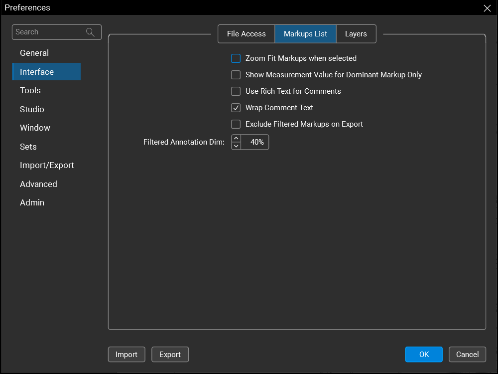

Zoom Fit Markups when selected: When enabled, the main Revu workspace jumps to the location of the markup on the PDF when a markup is selected in the Markups list.
Show Measurement Value for Dominant Markup Only: When markups are grouped, the values of the measurement columns (Count, Length, Area, Wall Area, and Volume) are automatically summed for the group item in the Markups list when all the markups in the group support the given measurement. Enabling this option causes these values to default to their equivalent values in the "dominant markup" (that is, the first markup selected when creating the group) of the group.
Use Rich Text for Comments: When enabled, comments in the Markups list use rich text format (RTF), as defined by the markup's properties. Otherwise, comments in the Markups list use uniform formatting.
Wrap Comment Text: When enabled, text in the Markups list is wrapped based on the width of the Comments column.
Exclude Filtered Markups on Export: When enabled, any markups that have been filtered out are not included in Markups list exports.
Filtered Annotation Dim Percent: Sets the dimmer level of the annotations when the filter is being used.
