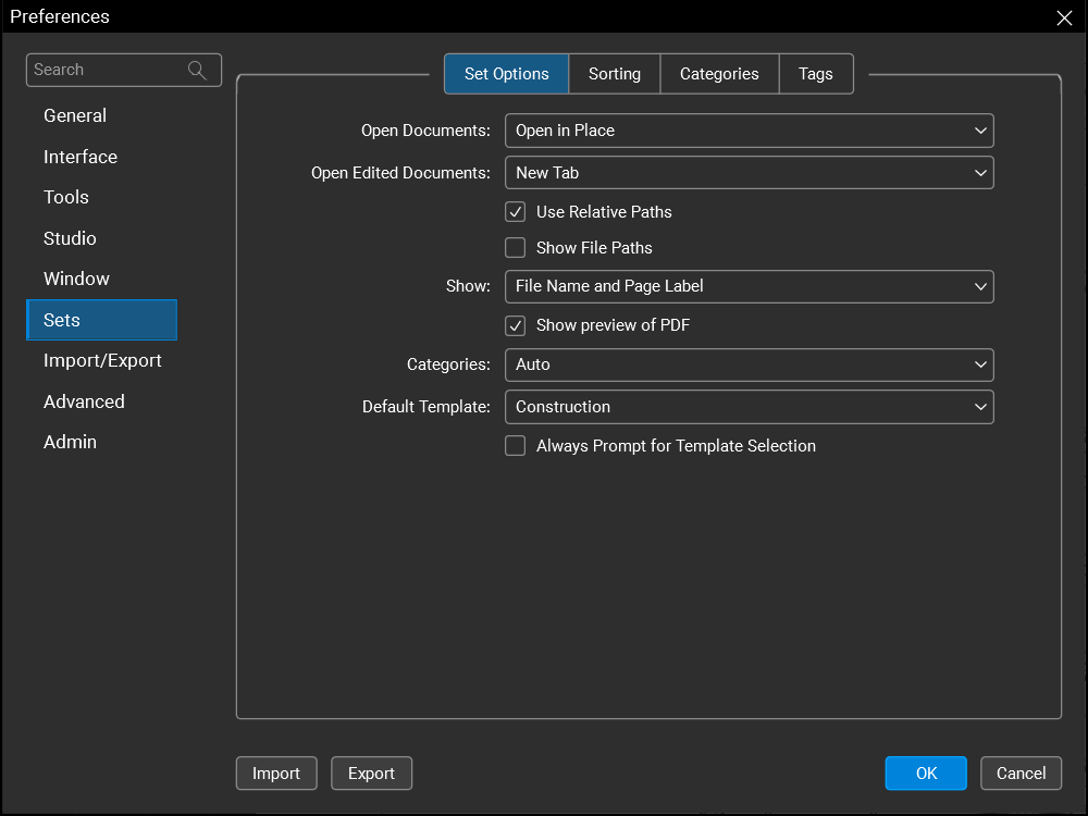

Open Document: Determines how new files in a Set should open when one file from the Set is already open in a tab.
- Open In place: New documents from a Set open in the same tab as the previous document.
- New Tab: New documents from a Set open in new tabs.
- New Tab in Front: New documents from a Set open in new tabs. Each new document is placed to the left of all the open tabs.
Open Edited Documents: Determines how new files in a Set should open when one file from the Set has been edited, but not yet saved.
- New Tab: Any new documents from the Set open in a new tab, keeping the last document open.
Use Relative Paths: When enabled, relative paths for the files in Sets are used by default. Otherwise, full paths are used. Relative paths store the location of PDFs in the Set relative to the Set's .bex file. See Understanding Relative and Full Paths for more information.
Show File Paths: When enabled, the full path to the documents in Sets is shown by default. When disabled, only the documents' names are shown.

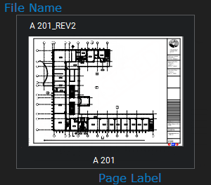

Show: Determines what data will be shown to identify documents in a Set. The options are to show file names and page labels or just one or the other, and to show sheet names and sheet numbers or just one or the other.
In the examples below, File Name and Page Label has been selected. Where they appear depends on whether Sets is currently in Thumbnail View or List View.
| Thumbnail View mode | List View mode |
Show preview of PDF: When enabled, a flyout preview of a PDF in a Set appears when the mouse cursor hovers over the PDF's entry in the Set list (only applies when the Set list is in List View).
Categories: Determines the default Categories mode for Sets. This mode can be changed for specific Sets when they are created. The options are:
- Off: Sets Categories are not used.
- Manual: Sets Categories are used, but sheets added to a Set are not automatically assigned a category. All sheets being added to the Set can be assigned to a category or categories can be assigned one at a time after the sheets have been added.
- Auto: Sets Categories are used and sheets are automatically assigned a category upon being added to the Set.
How Revu assigns a sheet to a category is determined by which Template is used. See Categories below for a more detailed explanation of how the category templates work.
Default Template: Determines the default Sets category template that is used to categorize sheets in a Set.
Always Prompt for Template Selection: Works in conjunction with the Auto and Manual Category modes. When selected, a dialog is presented during Set creation, allowing the user to choose a Category template. When not selected, the Default Template is automatically used.

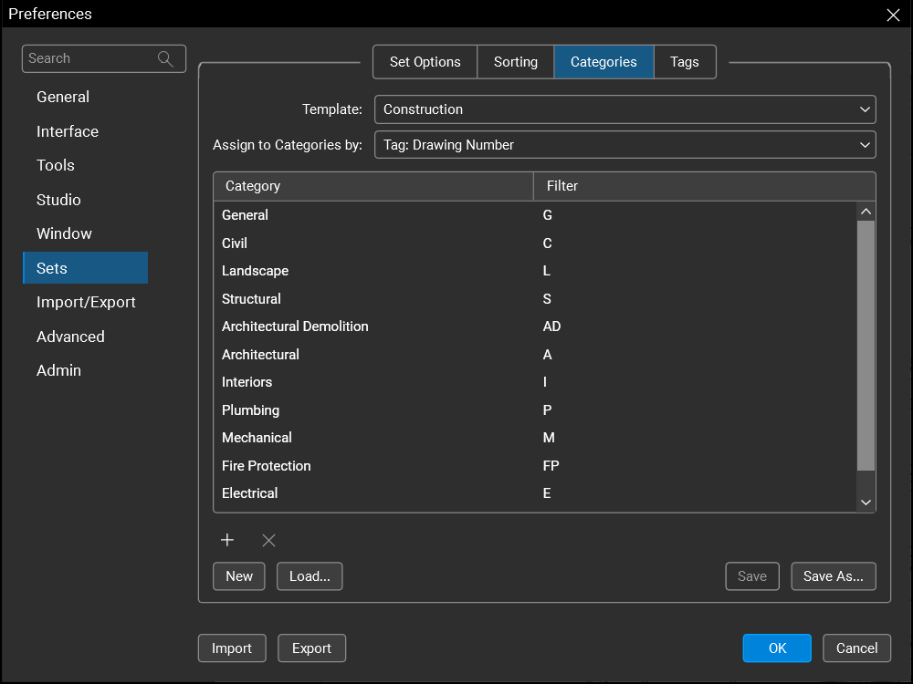

Categories are used to automatically sort sheets in Sets. Default categories are set up here.
Template: Indicates the current category template. To edit the categories in a template, select it from the dropdown menu.
Assign to Categories by: Select what data Revu uses to determine a sheet's category by default. The options are:
- File Name: The first letter or letters of a sheet's file name are used to determine its category.
- Tag: Drawing Number: The first letter or letters of a sheet's sheet number (as determined by the Drawing Number tag) are used to determine its category. If this option is selected, but the Sheet Number tag is disabled on the Tags tab, all sheets will be Uncategorized.
The default categories of the template selected from Template dropdown menu are shown in the table in the bottom of the tab. They can be modified by doing any of the following:
- Categories are arranged in the Set according to the sort order found here. Drag and drop to adjust the sort order.
- When a Set is configured to automatically assign Categories to sheets that are added, Revu compares the first letter or letters of the sheet's file name or Sheet Number tag to the values in the Filter column and, if a match is found, assigns the sheet to the corresponding Category. To change a Filter, double-click it and enter the desired value.
Multiple Filters can be assigned to the same Category. Separate multiple filters by a semi-colon (;). Some rules to consider when adding or changing Filters:
- Spaces and other special characters are considered literal characters.
- When a sheet can be sorted into multiple Categories, Revu will automatically choose the strongest match.
- Identical filters are not allowed.
- Categories can be added (
) or removed (
). - Save As saves the configuration as a new template with a name you specify without changing the original template.Revu can be configured to prompt which template to use by enabling Prompt for Template selection in Sets (Options) Preferences.

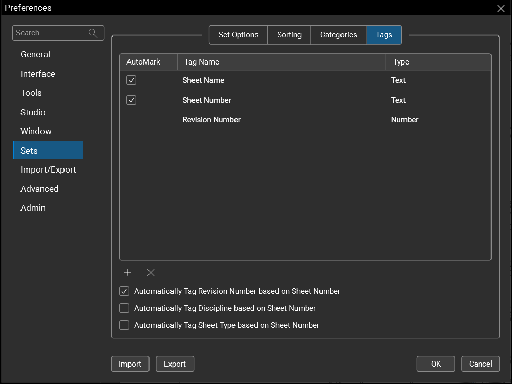

Select
. - To add one of the standard tags, select the Default tab and select the desired tag from the menu.
- To add a custom tag, select the Custom tab, then enter the desired Tag Name of the tag and select the appropriate Tag Type.
- Select OK.
- Select the tag to be removed.
- Select
- Select the tag to be moved.
- Drag and drop it to the desired position in the list.
Some tags (Revision, Discipline, and Sheet Type) can be extrapolated from sheet numbers. To do so, select any or all of the following options:
- Automatically Tag Revision Number based on Sheet Number: When enabled, the Revision tag automatically extrapolated from the Sheet Number tag. If the drawing's sheet number already exists within the Set, Revu assumes it is the next revision of that sheet. This option is only available when the Sheet Number and Revision Number tags are enabled. If either is not currently included in the list of tags being used, enabling this option adds it automatically.
- Automatically Tag Discipline based on Sheet Number: When enabled, the Discipline tag is automatically extrapolated from the Sheet Number tag. This option is only available when the Sheet Number and Discipline tags are in use. If either is not currently included in the list of tags being used, enabling this option adds it automatically.
- Automatically Tag Sheet Type based on Sheet Number: When enabled, the Sheet Type tag is automatically extrapolated from the Sheet Number tag. This option is only available when the Sheet Number and Sheet Type tags have been added to the Set. If either is not currently included in the list of tags being used, enabling this option adds it automatically.
