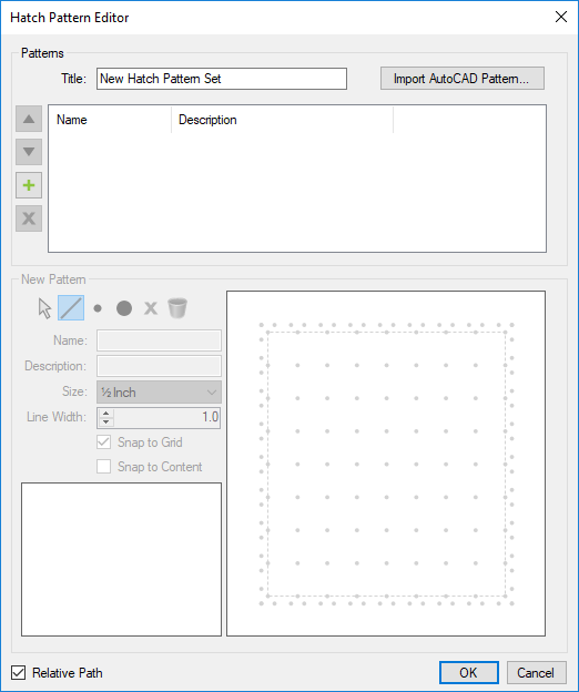

Select OK. The Hatch Pattern Editor appears.
- Add hatch patterns to the hatch pattern set, if desired. See Create a new hatch pattern in an existing set below (skip to step 6). Otherwise, select OK.

Select the desired hatch pattern set and select Modify. The Hatch Pattern Editor appears.
- In the Add Hatch Pattern dialog, enter a name for this hatch pattern in the Name field and select OK. The Hatch Pattern Editor reappears with the new hatch pattern listed.
- Select the new hatch pattern and edit it using the New Pattern controls, as desired. The grid in the lower-right corner represents one hatch tile in which you can draw the desired pattern using lines and/or dots. As you draw your hatch pattern, the lower-left field will preview it for you. The available controls are:
