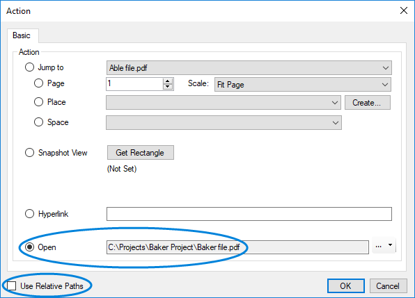

Relative Paths vs Full Paths are different ways for Revu to save the location of a file. Most people are already used to Full Paths: this saves the full folder path to the file. For example, in the hyperlink configuration shown below, Use Relative Paths is turned off, so the full path to the linked file (Baker file.pdf) is used.
The full folder path is saved (C:\Projects\Baker Project\Baker file.pdf). It doesn't matter where Able file.pdf is when the full path is saved; so long as it's anywhere on the same computer, it will be able to find Baker file.pdf (it still needs to be on the same computer in this example, however, so that it is looking in the correct C:\ drive).

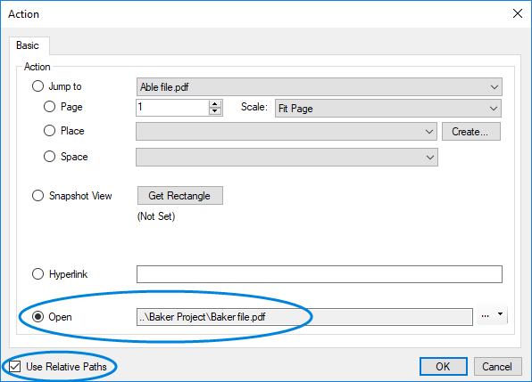

On the other hand, the location of Baker file.pdf can be saved according to its position relative to Able file.pdf by turning Use Relative Paths on, as shown below.
In this case, Revu does not know what drive Baker file.pdf resides on; what it does know is that, starting from the current location of Able file.pdf, it needs to go up one folder and find a folder called Baker Project.
In the Relative Path example above, the folder structure looks like this:
Since Able Project and Baker Project are in the same folder (Projects), the relative path from Able file.pdf to Baker file.pdf is simply go up to their common folder (Projects) and from there, go into the Baker Project folder to find Baker file.pdf.
The advantage of Relative Path is that it doesn't matter what folder Able Project and Baker Project are in; that information is not saved and Revu has no knowledge of it. All that matters is that both are in the same folder. So if you copied the Able Project and Baker Project folders and moved them to a different computer, so long as you moved both into the same folder, you could open Able file.pdf and the hyperlink to Baker file.pdf would still work. This makes projects very portable, so long as they are moved together and their relative positions are maintained (in this example, this could be accomplished simply by copying the Projects folder and all of its subfolders over to the new location).
The disadvantage of Relative Path is that both the file with the hyperlink (Able file.pdf) and the file being linked to (Baker file.pdf) need to be moved together. If just one or the other is moved, the link breaks.
