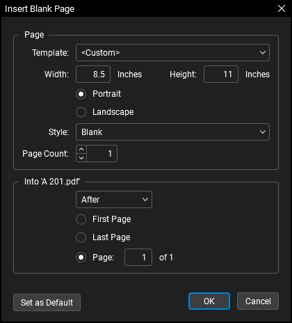

To insert a blank page or a new page from a saved template, use the Insert Blank Page command.
- Open the PDF into which you wish to insert pages.
Go to Document > Insert >
Insert Blank Page. The Insert Blank Page dialog appears.
- To select a template for the new page(s), select it from the Template dropdown menu.
- To set a custom size, enter the Width and Height values.
- To define the orientation, select either Portrait or Landscape.
- To choose a grid style, select it from the Style dropdown menu.
- Enter the number of pages to insert in the Page Count field.
- Determine where the inserted pages will be placed:
- Select Before or After from the dropdown menu below the name of the PDF into which the pages are being inserted.
- Select First Page, Last Page, or specify a Page.
The combination of these two choices determines where the pages are inserted. So, selecting After and Last Page will insert the pages after the last page of the current PDF.
- To set this configuration as the default for future use, select Set as Default.
- Select OK.
