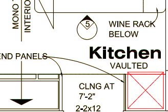

Overlay Pages allows you to merge PDF content from two or more files into one PDF that highlights the differences between the files in different colors. This feature is useful when you want to compare original and revised drawings, or when you want to view various building plans (e.g. electrical, HVAC, plumbing, etc.) layered in one PDF. Where the colors are stacked directly over each other, they blend to create a darker color, making it easier to see which elements have changed and which ones have remained the same from revision to revision. There is also a batch version of Overlay.
If you have Bluebeam Max, try Smart Overlay to highlight differences between two drawing sets and receive a match score across sheets and disciplines.
This feature is similar to Compare Documents, which compares two or more PDFs and uses markups to identify differences. The Overlay function works well for PDFs with vector graphics, while Compare Documents is best suited for working with scanned—that is, rasterized—images or drawings.
