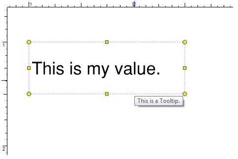

The Tooltip property holds a string of text that appears when the mouse hovers over the field, as illustrated below with the tooltip, "This is a ToolTip", being shown when the mouse hovers over the field.

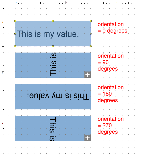

The Orientation property sets the angle at which the contents of the field will be rendered. There are four options: 0 degrees, 90 degrees, 180 degrees, or 270 degrees. An example of a Text Box with the various orientation options is shown below.
