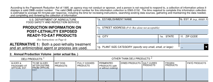

Revu supports the filling in of PDF forms. When PDFs are opened in Revu, form fields are highlighted in blue. Any required fields are highlighted in red. An example of the appearance of the form fields is shown below.
To turn off the highlighting, go to Tools > Form > Highlight.
