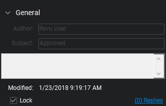

Locking a stamp protects it from accidental editing.
- Right-click the desired stamp and select Properties.
In the General section of the Properties panel, enable Lock.
