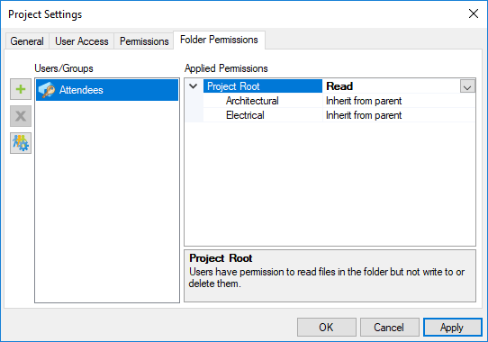

Folder permissions control user access to folders and the files within those folders. They do not apply to Hosts and administrators (that is, users with the Full Control permission set to Allow), who automatically have full access to all files and folders in the Project.
When in the Project, select
Project Settings on the Project tab. The Project Settings dialog appears.
Select the Folder Permissions tab.
The default group, Attendees, will be shown, as well as any other users or Groups that have been previously added. The Attendees group applies to all users in the Project and cannot be deleted. By default, the Attendees group is set to Read when the Project is created; a recommended best practice is to give additional permissions to specific users and Groups rather than allow greater access to the Attendees group.
- To add individual users or Groups:
- Select
. In the Add Users/Groups dialog, select the desired user or group and select OK. By default, when users and Groups are added, they inherit the permissions of the Attendees group.
Individual users will not appear in the list until after they have accessed the Project for the first time.If you are the Project owner and would like to create a new Group for this Project or change the membership of one currently being used, select
Manage Groups. See Studio Groups for more information about creating and managing groups. Users with Full Control permissions can also use Manage Groups to manage their own groups, but they will not be able to use those groups in this Project, only in those that they own themselves.
- Select
- To change the folder permissions for a user or Group:
- Select the desired user or Group in the Users/Groups list.
- Select the desired folder in the Applied Permissions list. A dropdown list arrow will appear to the right of the selected folder.
All Projects have a folder designated the Project Root. This root-level folder contains all folders and files in the Project, even though it does not show up in the list of Project files and folders on the Studio tab. The Project Root folder must have a permission state defined for it, but it is the only one; all other folders can be set to inherit their permission states from their parent folders.
- Select a permission setting from the dropdown list.
- When defining folder permissions for the Project Root folder, the options are Read, Read/Write or Read/Write/Delete.
- When defining permission for all other users and Groups, the options are:
- blank: This setting causes the folder to inherit the permission state defined for its parent folder (that is, the one in which it is contained). Not available for the Project Root folder as it has no parent folder from which to inherit a permission state.
- Hidden: This setting causes the folder and its contents to be concealed from the user or Group. They will not see or be able to access the folder or any of the files contained therein. The Project Root folder cannot be hidden. Further, any folders contained within a Hidden folder are also Hidden by default.
- Read: This setting allows the user to open Project files, but not check out, change or delete them.
- Read/Write: This setting allows the user to open, check out and make changes to Project files.
- Read/Write/Delete: This setting allows the user to open, check out, rename, make changes to and delete Project files.
Folder permissions do not apply to the Host or administrators (that is, users with the Full Control permission set to Allow). These users automatically have full access to all files and folders in the Project.
- To remove a user or Group, select them and select
. - Select OK.
