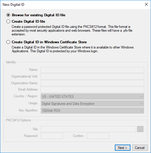

To create a new, self-signed digital ID, follow these steps:
Go to Tools > Signatures > Digital IDs. The Manage Digital IDs dialog appears.
Select
Add Digital ID. The New Digital ID dialog appears.
- Select one of the available Create Digital ID options:
- Create Digital ID file: Creates a digital ID in the PKCS #12 format. It is protected by a separate password that is defined at the time of creation.
- Create Digital ID in Windows Certificate Store: Creates a digital ID in the Windows Certificate Store. It is protected by the user's Windows login.
Since it relies on a user's Windows login credentials, Windows Certificate Store is not recommended for environments with shared login credentials. Additionally, the Windows Certificate Store is Windows-only while PKCS #12 is compatible with both Windows and Mac OS. - Enter the Identity information, as desired. Name and E-mail Address are required fields.
If Create Digital ID file was selected, enter and confirm a Password under PKCS #12 Options. This password will be used to confirm the user as the signer of a document, so use a sufficiently secure password.
Keep your password in a secure place. By design, passwords for these types of digital IDs cannot be retrieved or reset if lost. In the event that you lose your password, you will need to create a new digital ID. - Select OK.
When you create a self-signed digital ID, send copies of your public certificate to anybody who will receive documents with your digital signature so they can validate it. You should do so before sending them documents that you've digitally signed. Fortunately, Revu makes it simple to export your public certificate.
