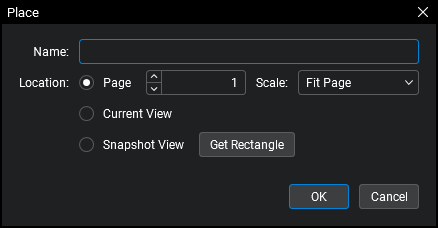

Hyperlinks can be created to Places in a PDF, which are defined and named anchors than can be placed anywhere on a document so that you can easily link to that location. Places can be moved on the PDF without breaking links to them, provided that their names remain unchanged.
To create a Place, follow these steps:
- Go to Window > Panels >
Links or press ALT+N to show the
Links panel. -
In the Places section of the Links panel, select
Add Place.
- Enter a name for this Place in the Name field.
Select one of the following options to describe the Location of the Place:
- Page: Use to define a page number in the PDF as the location, with option to define the scale.
- Current View: Sets the current page and scale as the location.
- Snapshot View: Use to define an area on the current page as the location. Once selected, select Get Rectangle and drag a rectangle over the desired area to set the view.
- Select OK.
