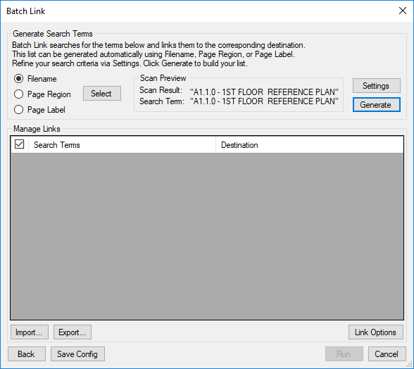

- To import a set of search terms and destinations that were previously saved as a CSV file (see Saving and Using Saved Batch Link Configurations), select Import. Otherwise, use one of the following options to generate search terms and destinations:
- Filename: Uses the file name for each PDF included in the batch process as a Search Term with the Destination being the page itself.
- Page Region: Uses the text found within user-defined regions as a Search Term with the Destination being the page itself. To define a region:
- Select Select to replace the dialog with a crosshair cursor.
Drag to define a region within the PDF.
The data in this region should be located in the same place on each PDF. After you define the region, the AutoMark dialog appears.
- To add another region:
- Select Add to replace the dialog with a crosshair cursor.
- Drag to define another region, which is added to the Selection field in the AutoMark dialog.
You may add as many regions as you need. Review the sample page label displayed under Preview. If desired, select the Selection field to add text before, after, or between [Regions]. - After you define all regions, select OK to close the AutoMark dialog and return to the previous dialog.AutoMark is most suitable for documents that are vector-based, are the same size and have the same registration. AutoMark might not work as expected if the pages are different sizes, if some of the pages are not searchable, or if the scans are not properly registered.
Page Label: Uses the predefined page label for each PDF included in the batch process as a Search Term with the Destination being the page itself.
- Click Settings. The Search Terms Settings dialog box appears.
- Select a combination of Filter Mode and Filter Character to automatically filter search terms, as desired.
- Filter Mode: First from start: Keeps all text from the start of the Scan Result to the first occurrence of the Filter Character.
Filter Mode: First from end: Keeps all text from the last occurrence of the Filter Character to the end of the Scan Result.
- Filter Character: Select one of the available characters or manually enter one.
- Select OK.
See the Preview for an example of the results.
- Click Generate. The Manage Links list is automatically populated.
