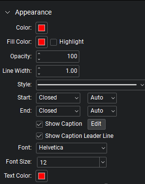

You can adjust the appearance of your measurement, including line and fill color, line width and style, opacity, and font options for the caption.
To change the appearance of a Length measurement, select the markup and select the Properties panel. Go to Window > Panels > Properties to show the Properties panel if it is hidden. Several properties will also be available on the Properties toolbar when the markup is selected.
Color: Sets the line color.
Fill Color: Controls the fill color of the endpoints.
Highlight: Makes the fill color and line transparent so underlying content shows through.
Opacity: Sets opacity level of the line and endpoints, from 0 (invisible) to 100 (opaque).
Line Width: Sets the line thickness in points. A setting of 0 effectively renders the line invisible.
Style: Determines the line pattern. In addition, there are several advanced line styles and you can create Custom Line Styles.
Start and End: Controls the appearance of the endpoints for each side of the line. The diagram below shows samples of each type of endpoint.
Each endpoint has an associated Scale that determines the size of the endpoint in relation to the Line Width. By default, it is set to Auto and will automatically adjust as the Line Width is changed.
Show Caption: Display caption text. Select Edit to choose which measurements to show.
Show Caption Leader Line: Select to show the leader line to the caption.
