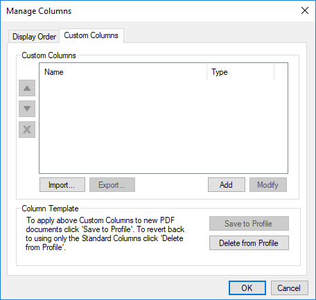

- On the Markups List toolbar, go to Markups List > Columns > Manage Columns. The Manage Columns dialog appears.
Select the Custom Columns tab. Any custom columns are listed.
Select Add.

Custom columns can be removed and reordered from the Manage Columns dialog. Additionally, custom columns can be added to all documents using the column template. On the Markups List toolbar, go to Markups List > Columns > Manage Columns. The Manage Columns dialog appears.
Reordering the List: Select a column name then use the
Up or
Down buttons to reorder custom columns.
Deleting a Custom Column: Select the Custom Column tab, then select a column name and select
Delete to delete it.
Automatically Adding Custom Columns to All Documents with the Column Template: Select the Custom Column tab, then select Save to Profile to add the currently defined custom columns to all PDFs opened or created in Revu. The columns will not be added to the PDF until data is actually entered into one of the columns. This is intentional, so that a save is required only if data has been added into one of the newly added columns (or some other change is made) and not simply because the PDF was opened. Select Delete from Profile to remove the template from future PDFs.
