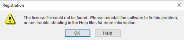

You see the following error message when registering Revu: The license file could not be found. Please reinstall the software to fix this problem, or see troubleshooting in the Help files for more information. Screenshot of the error message

These issues are permission-related conflicts that occur when installing Revu without the proper licensing server authorizations.
