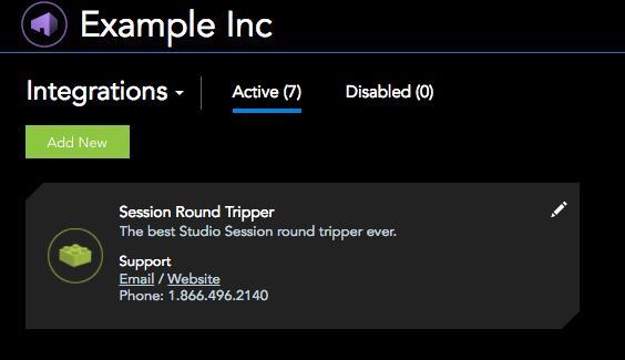

How to Enable an Integration from the Studio Prime Portal
Once your organization has met the requirements above, an Admin of the Studio Prime space can enable the Integration by following these steps:
  1. Log into the Bluebeam Studio Prime portal from your browser.
  2. Click Integrations in the upper right corner.
  3. Click the Add New button.
  4. Enter your Integration ID in the appropriate field and click Lookup.
  5. Verify that the correct Integration is displaying and click Save.
All Members of your organization's Studio Prime space may use the Integration now.
