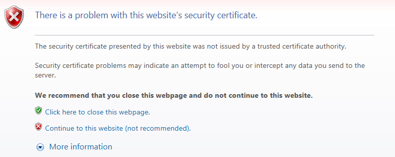

If when accessing the Studio Portal on the client system you receive a security certificate error (shown above), follow these steps to verify the certificate name and install the certificate:
  1. Close and restart Internet Explorer as an Administrator
  2. Return your Studio Portal (https://YourServerURL)
  3. Select Continue to this website (not recommended).
  4. Select Certificate Error in the Address Bar, and select View Certificates.

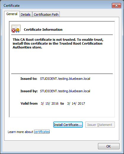

    This will display information about the website's certificate:
    Bluebeam studio view certificate
  5. Check the Issued to name and verify this name matches the machine name of the server where Studio Enterprise is installed.
    • If the name does not match, you will need to update the Hostname in the Studio Enterprise Administrator.
    • If the name does match, click Install Certificate and follow the prompts to install the certificate into the Trusted Root Certification Authorities Certificate Store, under Local Computer if available. See this article for instructions.
