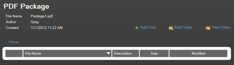

To create a new PDF package:
  1. Go to File > Create >  PDF Package. A new, unsaved package document container is opened.
  2. Add individual files to the PDF package:
    1. Select  Add Files.
    2. Select the files to add and select Open. Or, files can be dragged from Windows Explorer.
      As files are selected and added, thumbnails will be generated and the files will appear in the list.
  3. Whole folders can be added as well, which will automatically add all files and subfolders. To add folders to the package:
    1. Select  Add Folder.
    2. Select the desired folder, then select OK. Or, files can be dragged from Windows Explorer.
