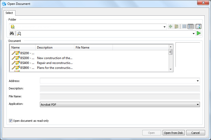

Select the desired ProjectWise datasource and select OK. If you are prompted to log in, do so. The Open Document dialog appears.
If Always Show Selection Dialog is not enabled in File Access Preferences, the Open Document dialog opens directly. - Navigate to and select the desired document in the Document window. The Address, Description, and File Name fields will populate with available data to confirm that the correct document has been selected.
- To both open and check out the file, uncheck Open document as read-only. Otherwise, the file will open without being checked out.
If Open document as read-only is already unchecked, the configuration settings for this DMS are set to automatically check out files when they are opened. Check it to open the file without checking it out.
- Select Open. The file appears in the Revu workspace and, if appropriate, is checked out.
