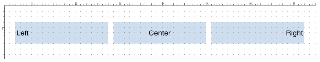

Alignment: Specifies how the text will be rendered inside the Text Box, as illustrated below.

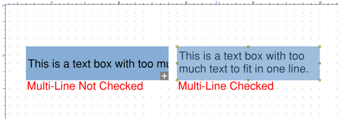

Multi-Line: Enables text wrap inside the Text Box, as illustrated below.

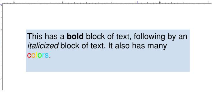

Allow Rich Text Formatting: Enables the use of the same controls that manipulate markups in Revu to modify how text gets rendered inside the Text Box.

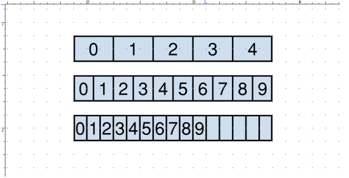

Comb of N Characters: Allows the text box to be broken down into N individual characters. When creating forms to be printed, specifying this property makes it easier to manually enter data. It also ensures that no unnecessary data is shown in a form. The example below illustrates N = 5, N = 10, and N = 15 on three text boxes of the same size. All three text boxes contain the same data, but the comb limits how much of that data can be shown.
