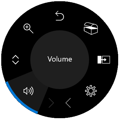

All Surface devices can take advantage of the Surface Dial menu, which places commonly used features in a menu accessible using the Surface Dial. Press the Surface Dial to call up this menu. If the Surface Dial is currently on the screen, the menu will encircle it, otherwise it will appear on the screen as a stand-alone wheel menu. It's comprised of standard Surface Dial menu items as well as Revu-specific menu items, including:
  • Volume: Adjusts the volume of the device's speakers.
  • Scroll: Scrolls the main workspace either up & down or left & right. Press the Surface Dial to switch the scroll direction.
  • Zoom: Zooms the main workspace in and out.
  • Undo: Undoes and redoes actions in the history. Continue scrolling left to undo actions in order or scroll to the right to redo undone actions.
  • Tool Chest: Opens the Tool Chest panel. See Tool Chest Panel below for more information about how the Surface Dial interacts with it.
  • Split-Zoom: Engages MultiView and splits the main workspace vertically. Rotate the Surface Dial to zoom the split view in and out while maintaining the view of the original document. See On-screen Features below for more detail regarding using Split-Zoom when the Surface Dial is on the screen.
  • Properties: Engages a limited menu of markup properties in a separate wheel. When a markup on the document is active, the properties for it can be changed. When no markup on the document is active, but a markup on the markups tab is, the default settings for that markup can be changed. Otherwise, the menu will be dimmed. The properties available include Line Width, Color, Fill, and Opacity (both Line and Fill, when applicable).
  • Panels: Opens the Panels menu. Selecting a panel will open it (if necessary) and make it active.
