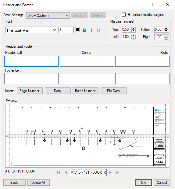

- To use a previously configured header/footer template, select the template from the Save Settings list. Select OK to use the template unmodified, or proceed to the next step to make modifications.
- In the Header and Footer section, there are six boxes representing the right, left, and center areas of the header and footer. Add information to any of these by selecting the desired box and entering text or selecting one of the four Insert buttons:
- Page Number: Auto-generates a page number value in the chosen format.
- Date: Auto-generates the date in the chosen format.
- Bates Number: Auto-generates a Bates number with fixed number of digits and a user-defined prefix and suffix.
- File Data: Inserts a selected file property, such as the file name, document path, author, and more.
- Select the desired settings in the Font section to define the appearance of the text.
- Adjust margins by setting the values in the Margin section.
- Margin settings are visible in the Preview section as dashed blue lines and update dynamically when changes are made.
- To shrink page content to fit within the margins, select Fit content inside margins.
- Use the navigation controls under the Preview window to check that the header or footer does not overwrite information already on the pages.
- To save this header/footer configuration for use on future documents:
- Select Save at the top of the dialog box.
- Enter a name for this configuration in the Save Header Footer Settings as field and select OK.
- Select OK to apply the header/footer.
