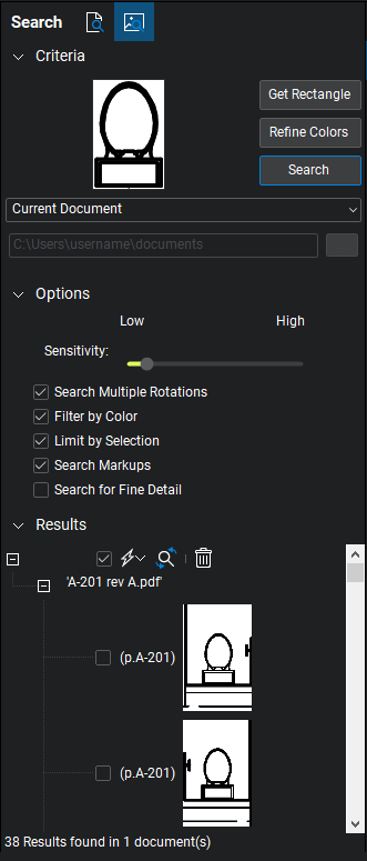

Use Visual search to search for all instances of a visual objection that occurs in a document.
How to use Visual search Video2:22
Discover how to use Visual search to help you get the most out of Revu. Watch at Bluebeam University.
To learn how to perform a Visual search on a PDF, see Visual search overview.
- Sensitivity: Determines how closely the images need to match to be considered a valid result. Adjust the slider to set a lower or higher sensitivity. Lowering the sensitivity will allow for matches that have minor differences, like an adjacent line, but may also result in false positives.
You might need to lower the sensitivity if you are working on a PDF created from a scan because there may be stray pixels or background noise in the PDF.
- Search Multiple Rotations: Symbols will be searched at 0, 45, 90, 135, 180, 225, and 270 degree rotations.
- Filter by Color: Enables the Refine Colors button. The search will filter out colors that are not part of the selection (or in the selected range in the histogram).
Limit by Selection: On a vector PDF, this option filters out vector objects that extend out of the selection rectangle, as shown in the example below.
The search results are shown in the Results section. A graphic of the search result and a small area around it will appear in the results list. Select the image, and the main PDF workspace will change to show that result and the area around it.
Working with search results for VisualSearch is similar to working with results for Text Search, though text-based actions are not supported. Additionally, Count measurements can be applied to the results of a VisualSearch.
To apply Count measurements to the search results, follow these steps:
- Select the results that should be counted.
From the
Actions menu, go to
Apply Count Measurement to Checked and select the desired Count symbol to apply to the selected results.
