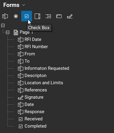

  1. Go to Tools > Form > Check Box.

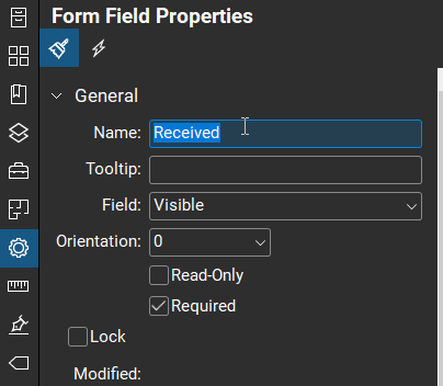

  4. Right-click and select Properties, which will launch the Form Field Properties panel.
  5. Under General, be sure to name the new form field. You can also edit its appearance and layout or add an action.

    To reselect a form field, you'll need to launch the Forms panel (Alt+Q) and select it from the list. When done editing form fields, press Esc twice to fully exit.

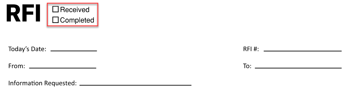

  7. To create a label for the new check box, go to Tools > Markup > Text Box. Then click-and-drag a text box next to the form field.
    Examples of check boxes on an RFI form
