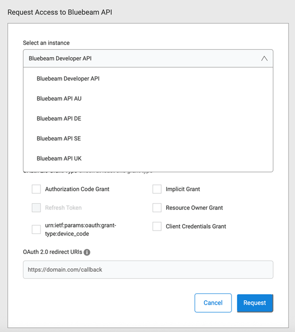

Request access and create a Client ID.
Go to My Apps and click Request Access.
Fill out the Request Access form (see screenshot below). Select the Bluebeam API instance associated with your specific region.
Bluebeam Developer API is the US server.
- Authorization Code
- Refresh Token
Redirect URI: use
https://oauth.pstmn.io/v1/callbackThis URI is specific to making calls in Postman. Alternate API tools or your App will require a different URI. -
Select Request to submit the form.
Bluebeam API supports only the following selections for Grant Type:Approval email

Go to My Apps and select Request Access.
Note for Grant Type:Only select the boxes next to:
- Authorization code
- Refresh token
